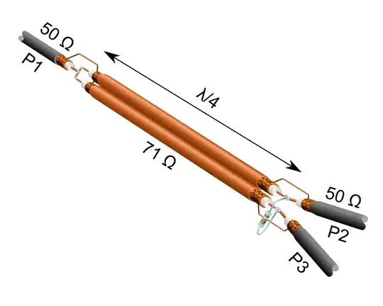

In your specific case, there's good reason to simply implement such a splitter yourself, as you want to have control over the splitting/combination.
The typical way to do that here is the Wilkinson Power Divider in coaxial implementation:
Wilkinson Divider in coax impl
With that, not only do you split the power half and half (if you transmit into P1), or combine with equal gain (if you receive on P2 and P3), but you also isolate P2 and P3, meaning that no power from P2 ends up on P3 and vice versa.
I was just assuming you're using 50Ω line; if you're not, that $\frac\lambda4$ piece needs to be $\sqrt2$ of your system's impedance.
71Ω might be hard to get, 75 Ω usually easy; the mismatch should be minimal.
