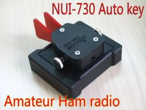

So my problem was when I plugged in my paddles. They would not activate the keyer at all.
This particular set of paddles:
Which provide a 1/8 inch stereo jack output.
Connected to the rig by an audio-quality male-to-male 1/8 inch stereo pigtail.
There are no menu changes necessary to switch between straight keys and paddles. The radio is smart enough to know the difference.
My problem is that the straight key works fine but the paddles are not responding at all.
Question: How to make it work? I know I have all the correct components.

Turns out that the stereo jack on the FT-450 is very picky about the connectors. Not to say it is a bad design but when it doesn't work it can be frustrating.
The solution was to simply turn the cable around. The radio is not happy with one of the connectors but is very happy with the other end.
Moral of the story: The jack on the radio is not very tolerant of connectors that are not exactly perfect. Jiggling can sometimes help but not always.
Now the paddles are working great with the radio.
Go figure.
This setup works great now. The paddles have non-stick rubber feet and is just heavy enough that it can be used without having to fasten it down.
