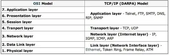

I don't see anything wrong with being able to differentiate layers between the two models. On the plus side, having knowledge of the OSI model comes in handy when you're talking to people or reading documentation referencing the top 4 layers of the OSI model:
Here are some links with explanation on what each layer does:

Your numbers in the right hand column are not helpful - they may lead people to confuse which "layer" people are talking about when they say "layer 2" (which IMHO always means the Data-Link layer). – Alnitak May 20 '09 at 14:50
What right-column numbers? What are you talking about? ;) Thanks for pointing that out! – l0c0b0x May 20 '09 at 15:46
Also the left hand side says tranport instead of transport, but I'm too tired to fix it at the moment =p – cutrightjm Dec 20 '14 at 07:05
