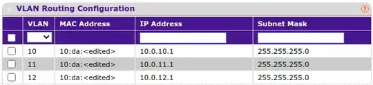

While all three machines are using the netmask 255.255.0.0, the routing configuration is set like this:
Now, the problem. When I send a TCP or UDP packet from 10.0.10.5 to 10.0.11.5 (for instance by doing nc -n 10.0.11.5 100), I can see this packet in Wireshark running on the machine which belongs to VLAN 12. It doesn't work the other way around, though, i.e. a packet sent from 10.0.11.5 is not visible in VLAN 12.
What should I do in order for the packets targeting machines from VLAN 11 to never reach the ports belonging to VLAN 12?
