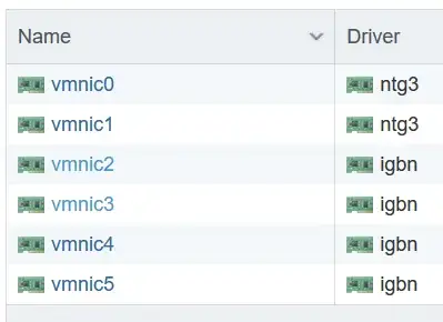

The NICs in ESXi look like this. The first two are the onboard LAN. The last four are the PCI-E card: Dell Intel I350-T4 Quad Port 1GbE PCI-E card. The ISP's connection is using vmnic2, the first port on the PCI-E card.
