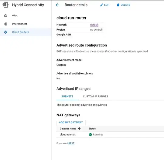

- Created a cloud router:
gcloud compute routers create cloud-run-router --network=default --region=us-central1

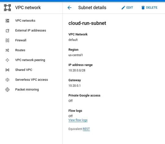

- I also created a subnet on the network:
gcloud compute networks subnets create cloud-run-subnet --range=10.20.0.0/28 --network=default --region=us-central1

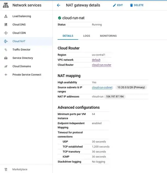

- Then I created a new Cloud NAT Gateway with this router and subnet:
gcloud compute routers nats create cloud-run-nat --router=cloud-run-router --region=us-central1 --nat-custom-subnet-ip-ranges=cloud-run-subnet --nat-external-ip-pool=cloud-run

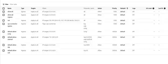

I also setup some firewall rules, to try to allow everything:
