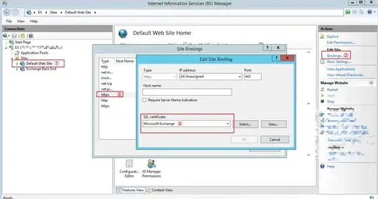

Our certificates. There's some old ones in here but they're not assigned to any services.
