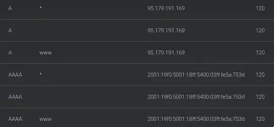

I have read other answers to similar questions on this site which point to Firewall blocking port 80, but there is no Firewall set up from the Vultr side. Also, these are the records I currently have on my DNS:
I'm not sure what I'm doing wrong. I appreciate any assistance with this.
