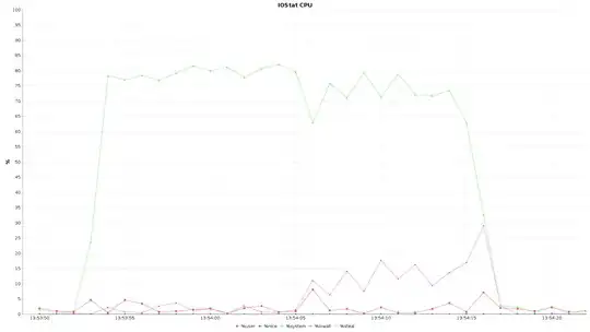

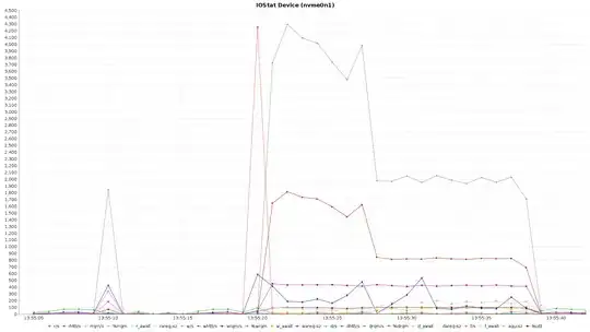

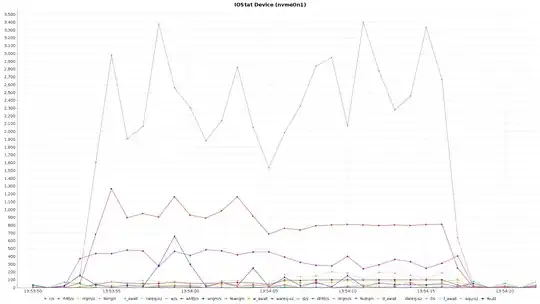

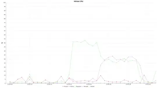

Discovered some 'interesting' behaviour:
- increasing number of parallel clients increases bandwith utilization; with 1 client, the target machine is writing 900Mbits/sec; with 4 clients 1.26 Gbits/sec (more parallel clients beyond 4 have detrimental impact)
- testing write on a more powerful machine with AMD Ryzen 5 3600X and 64G RAM (identical NVME drive + 10G NIC) -- 1 client can reach up to 1.53Gbit/sec, 4 clients 2.15Gbits/sec (and 8 clients 2.13Gbit/sec). The traffic in this case flows through Mikrotik CS309 switch and MTU is 1500; the more powerful machine seems to receive/write faster
- there is no noticeable load during tests -- this applies to both small and the larger machine; it is 26% for 2 cores maybe
