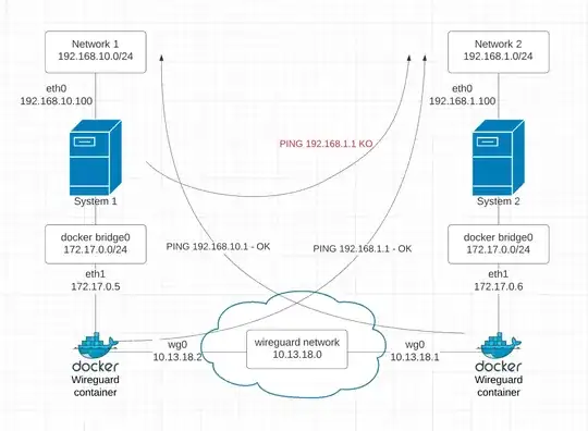

I am trying to have two containers, running on two RPI, act as a site-to-site VPN between Network 1 and Network 2.
With the setup below, I am able to ping from within the container each other network:
- from docker container 1 I can ping an address 192.168.1.1
- from docker container 2 I can ping the address 192.168.10.1
But if I try to ping 192.168.1.1 from the System1 host (192.168.10.100) I have errors (see below image to visualize what I am trying to do).
I understand I have to add a static route on system1 host (192.168.10.100) to direct the traffic for 192.168.1.0/24 through the wireguard container (172.17.0.5), thus I run:
$i p route add 192.168.1.0/24 via 172.17.0.5

| Site 1 | Site 2 | |
| Network 1 IP range | 192.168.10.0/24 | 192.168.1.0/24 |
| host system address | 192.168.10.100 | 192.168.1.100 |
| bridge docker0 range | 172.17.0.0/16 | 172.17.0.0/16 |
| container address | 172.17.0.5 | 172.17.0.6 |
