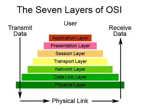

Hmm... For get a good understanding you will need an understanding about OSI model. But I will try to explain them as simple as possible.
Basically any networked transmission is going through the indicated path. In simpler words the data you sent is converted into electrical signals to transmit over physical link.
The bottom layer just has an idea about electrical signal not about any bits or bytes. The layer 2, Data link layer has an awareness about MAC addresses. When we are coming to layer 3 - Network layer we have some more high level approach, it can process IP addresses as well.
When we are talking about a router, router is a Layer 3 device, that can work with IPs. It can take decisions based on IPs. as an example route a packet based on IP or filter packets.
But Switch is just only a Layer 2 device. I just worries only on Physical addresses. (MAC addresses) and all the data communication is done using MACs.
