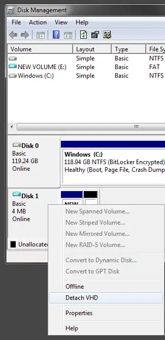

After you attach the vhd, you can remove it by going into disk management and right clicking the left side box of the vhd drive. The left side box is the area that says the Disk name, disk type and size. If you right click white area of the drive, the delete command is grayed out. Let me know if that helps.

The option is there. I wonder why it's only there, and not in the right click menus anywhere else... such as in the top pane where the drives are listed, and the VHD is colored blue unlike the others. The interface could really use some work, and they should put the option anywhere you right click the drive. – Triynko Mar 26 '10 at 03:44
In Disk Manager, left click on the VHD on the bottom half of the screen (where it visualizes disk space). The option to unmount is there.

To detach vhd in windows 7 in disk manager right click on the Disk # of the VHD (just to the left of the drive layout image - which is in the bottom half of the screen) from the option choose offline.. after that right click on the same place and u will get the DETACH option..
first u need to make the VHD OFFLINE and then u will get the DETACH OPTION in windows 7
