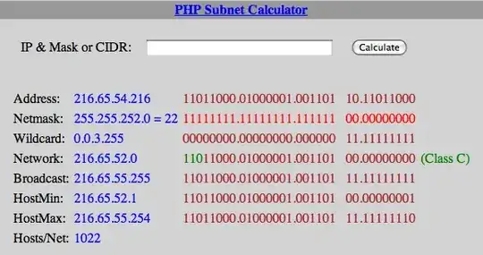

It is very error prone to calculate non trivial networks by hand. Try a CIDR Calculator instead.

On the contrary, I think it's good to completely understand CIDR and be able to do calculations in your brain... but sometimes you want to double check your calculations. I like to use the PHP Subnet Calculator: http://share-foo.com/SubnetCalc.php
