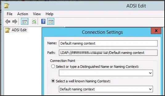

I found easiest way:
You can also find from
Active directory server -> Choose the Organization Unit OU -> Right Click -> Properties -> AttributeEditor -> DistinguishedName
I got these from Microsoft windows server 2012 R2
