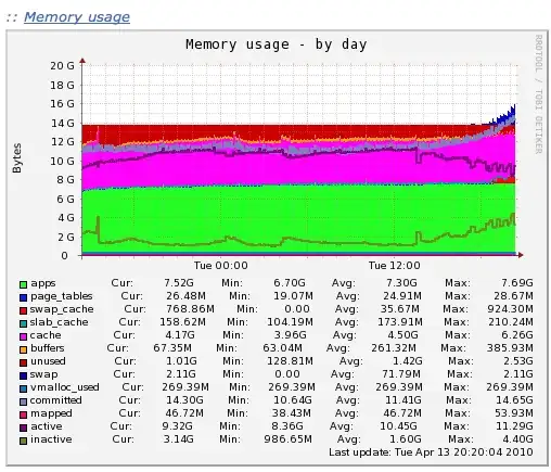

I have heavy application running on a CentOS server and I'm seeing a strange memory behavior. Here is a snapshot of a munin graph:
As you can see the amount of committed memory increases gradually causing the swap file to be use. What strikes me odd is that the amount of inactive memory keeps growing as well. It is my understanding that the inactive memory is actually memory freed up but not yet clean by the OS and put back in the free memory pool. It seems that running out of memory is acutally caused by this lack of clean up, but I may be wrong.
Can you give some tips to find the cause of the problem and/or cause CentOS to reclaim the inactive memory?

Some extra info:
1) I have a tmpfs mounted on /tmp and the number of files stored there grows (but it is double the amount of the inactive memory).
2) cat /proc/meminfo (at a later stage than the image) gives:

3) The application is a combination of MySQL, Heritrix (http://crawler.archive.org/ ) and a Tomcat based Java servlet to manage things.
