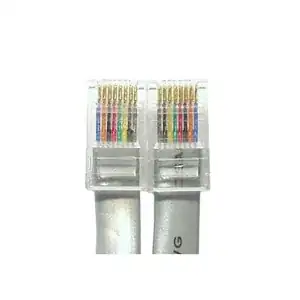

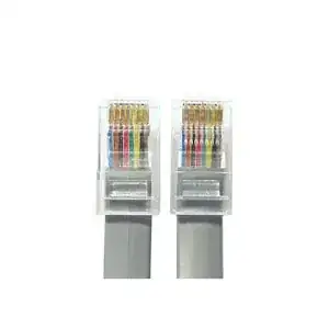

Here's a description of the cable:
- Sysadmins usually assemble these on their own, but I'm looking to save time and buy them.
- RJ-45 connectors on each end.
- Color is usually light-grey.
- Flat (not round). No shielding, no twisted-pair, etc. These are NOT cat5e cables. These are intended for low data rates (9600 bps - 115200 bps ).
- These are low profile, very flexible and don't take up much room in the cable management system. This is important when dealing with 42 servers and potentially 150+ cables in a rack.
- Sysadmins often use Ethernet cable instead of this cable, because Ethernet cables are available everywhere.
- These are similar to Cisco's light-blue rollover cables with a DB9 connector on one end. But I need some without the DB9 adapter.
