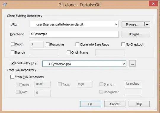

For TortoiseGit
When using TortoiseGit, you need to set the SSH key via pacey's directions. You need to do that for every repository you are using TortoiseGit with.

4pacey's instructions for tortoisegit won't work until you have the repository (because the 'remote' configuration setting doesn't appear unless you act on a repo), and you probably can't get the repository in the first place if you can't authenticate yourself in order to clone from the origin. Tricky! – Kylotan Oct 06 '11 at 19:59

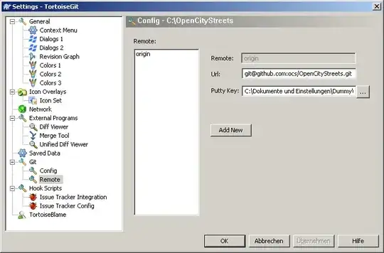

You can specify the key location for TortoiseGit the following way:
- Open an Explorer Window.
- Open the Contextmenu and navigate TortoiseGit → Settings
- In the now opened window, navigate to Git → Remote
- Set the path to your PuTTY key in the corresponding input box.
A screenshot is below:

9Additionally if you need to convert your private key into '.ppk' format from other format you can follow [THIS](http://develop-for-fun.blogspot.com/2013/12/configure-tortoise-git.html) – Tariq M Nasim Dec 18 '13 at 11:04
6Git > Remote only appears once you've successfully cloned the repository. – Steve Pitchers Jul 23 '15 at 09:18

TortoiseGit lets you specify the key to use when cloning a repository. Simply check "Load Putty Key" and browse to the .ppk file, as in the screenshot:
If disabled, check `Settings... -> Network -> SSH client` is set to `C:\Program Files\TortoiseGit\bin\TortoiseGitPlink.exe` – Nikita Bosik Nov 01 '17 at 11:49
