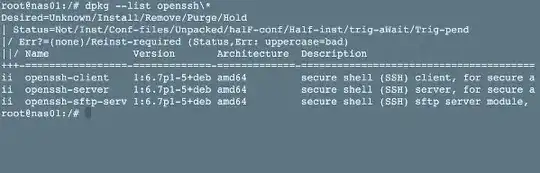

How to find openssh version on a Linux or Unix-like system?
The syntax is as follows to find openssh version on a CentOS/RHEL/SL:
# yum list installed openssh\*
The syntax is as follows to find openssh version on a Debian/Ubuntu Linux:
$ dpkg --list | grep openssh
### OR ###
$ dpkg --list openssh\*
