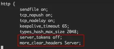

1) Install nginx-extras package alongside nginx:
apt install nginx-extras
2) Open nginx.conf and add following lines inside http block:
more_clear_headers Server;
server_tokens off;
3) Restart nginx

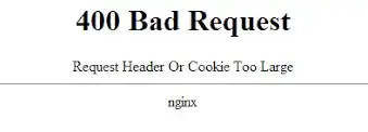

Just want to point out that even though the server header is removed from response, the name of the server (nginx or openresty e.g.) is still clearly visible in the html error response that the server sends in case of an error.
Anyone can very easily get this response by e.g. sending a header that is too long. Nginx will return a 400 Bad Request, that does not contain a server header (if fixed), but the html itself will show it:
P.S. I don't know how to get rid of this one as well, really the html itself will give it away, so there should be a way perhaps to not generate these at all?

2Use the `error_page` directive for all the errors you want to customize. For instance, `error_page 400 /err/400` will serve whatever's at `/err/400` in place of the default response. – Ivan Vučica Nov 16 '20 at 18:44
