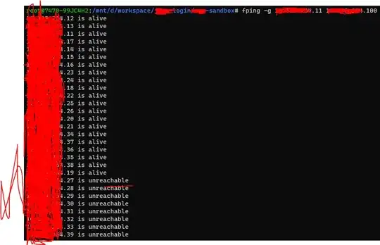

You can use the command fping to find the used and unused IPs of your network.
As mentioned elsewhere - a list with the IP-addresses of all hosts that respond to Ping is not (necessarily) the same as all IP-addresses that are actively used. – Bob Jan 19 '21 at 08:28
fping only resolve IP's which respond to ICMP if ICMP is droped then it will show th host unreachable even IP address in use – Vaibhav Panmand Jan 19 '21 at 12:25
