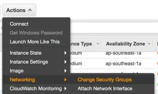

Now you can change the security group of an EC2 instance from the web console itself.
Select an instance -> right click or click Actions -> Under Networking -> select Change Security Groups

8This should be the accepted answer. You can change security groups of an instance – Shrey Feb 02 '17 at 07:32
1@Shrey The question was asked in 2011 when the web interface wasn't available. The accepted answer was probably the best option then :) – Slartibartfast Feb 02 '17 at 08:39
1As for 2022, It has changed to Actions -> Security -> Change security groups – Diogo Melo Jun 20 '22 at 23:59
