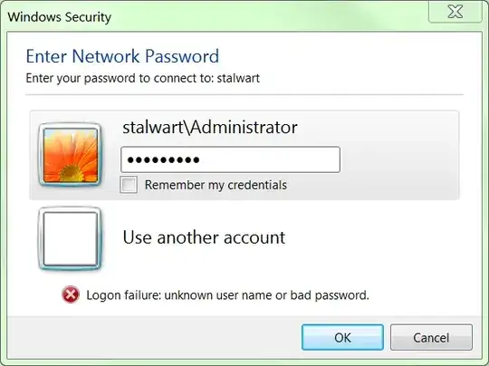

i'm trying to access the shares on a server. The credential box appears, and i enter in a correct username and password, and i get access denied.
The silly thing is that i can Remote Desktop to the server (using the same credentials), and i can check the Security event log for the access denied errors:

i've tried the password many times, uppercase, lowercase, on different user accounts, with and without prefixing the username with servername\username.
What gives that i cannot access the server over file sharing, but i can access it over RDP?
