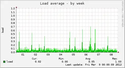

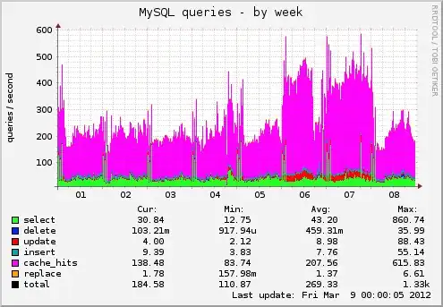

I have taken the load average from a small Magento website (4,000 unique visitors per day). You can see for yourself that the separate DB server uses very little CPU and resources in general. In fact, the only thing it does require is a lot of RAM.
MySQL is absolutely not the bottleneck for any Magento installation. But if you must use two servers....

Database server load

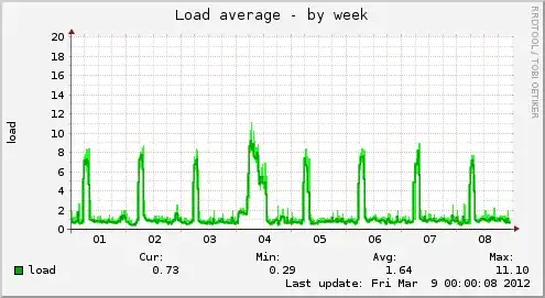

Web server load

Having had to bounce the php memory_limit up to 512MB for certain processes to run, I've watched each Apache process loaded essentially bug out memory wise. You will learn to drop mod_php5 really quickly as turning your Apache web services into php interpreters IS NOT THE BEST USE OF RESOURCES. Under FastCGI you get to run Apache WorkerMPM returning it to serving html which it does best while FastCGI runs the PHP interpreter as a separate process. On top of this you will need some sort of opcode caching. Your primary fastest server optimized for memory and CPU use needs to be your Web/PHP server. Your secondary server optimized for fast disk I/O is where you run MySQL services.
It's common with two server systems to run a quad core system with 12GB+ memory for the web server and a two core system with 8GB+ and a fast disk subsystem for the db server.
