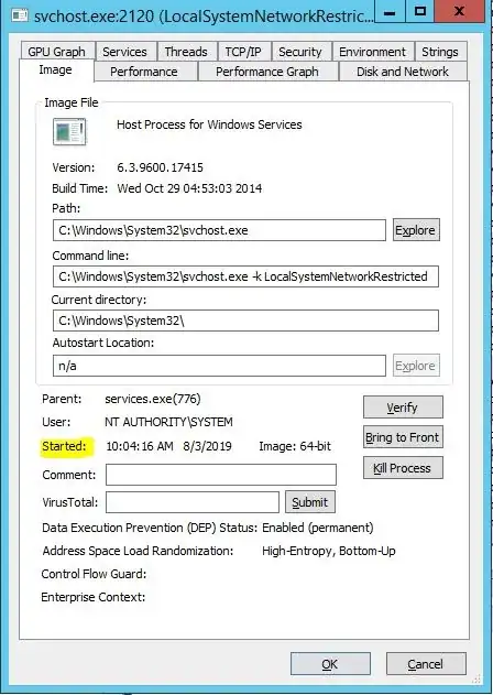

You can see this with Process Explorer. In the taskbar menu select View and check Show Process Tree and the Show Lower Pane options. Right click on any column and Select Columns, now click on the Process Performance tab and check the Start Time box.
Community Update:
As mentioned in the comments, in more recent versions of the tool (currently as of 2019), the information has been relocated into the image tab of the property sheets regarding each process-tree item (Just double-click the process name, no other steps are required).

Or you can right click, Properties and on Threads tab, there is start time. – Betlista Aug 11 '17 at 08:49
In the link, Download section, "Run now from Sysinternals Live", when running, the `process tree` is not clickable in the view. I have windows 7 enterprise, so maybe it is blocked by my firewall. – Timo Jan 17 '18 at 13:37
1This answer is outdated. For Process Explorer v16.26, right click the process -> Properties -> Threads tab -> start time is listed below. No need to check `Show Process Tree` or `Show Lower Pane`. The `Performance` tab does not list start time any more. The lower pane isn't used to find the start time. – BurnsBA Jul 22 '19 at 13:14
