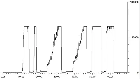

The shape of the transfer (without Nagle) is:
The Dip around 10s has ~100 duplicate acks.

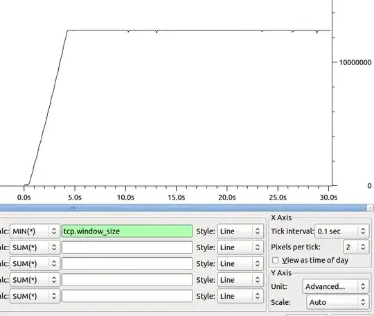

The Shape of the Min Window size of the receiver over time is:

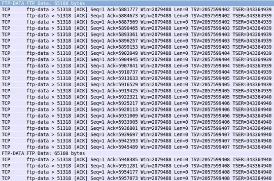

Digging into this a little bit deeper with Tall Jeff we have found something strange. According to the TCPDump on the sender's side it send the packets as 65k packets over the Internet. When we look at the dumps on the receiver side they arrive fragmented 1448 as you would expect.
Here is what the packet dump looks like on the Sender side:
What happens then is that the sender thinks it is just sending 64k packets, but in reality as far as the receiver is concerned it is sending bursts of packets. The end result is messed up congestion control. You can see this is a graph of the the packet lengths of data packets being sent by the sender:
Anyone know what might cause the Sender to think there is a 64k MTU? Maybe some /proc, ethtool or ifconfig parameter? (ifconfig shows the MTU is 1500). My best guess right now is some sort of hardware acceleration -- but I am not sure what specifically.
