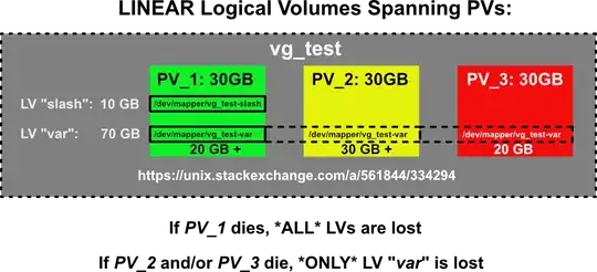

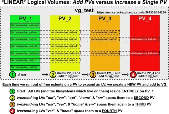

I've seen folks advocating (StackExchange & elsewhere) extending VM space laterally: increasing space by adding ADDITIONAL PVs to a VG vs increasing a SINGLE PV. It's ugly and spreads your filesystem(s) across multiple PVs, creating a dependency on an ever-longer & longer chain of PVs. This is what your filesystems will look like if you scale your VM's storage laterally:
I've seen lots of confusion over this. If a Linear LV- and the filesystem which lives in it- are spanned across multiple PVs, would experience FULL or PARTIAL data loss? Here's the answer illustrated:
Logically, this is what we should expect. If the extents holding our LV data are spread across multiple PVs and one of those PVs disappears, the filesystem in that LV would be catastrophically damaged.
Hope these little doodles made a complex subject a bit easier to understand the risks when working with LVM
