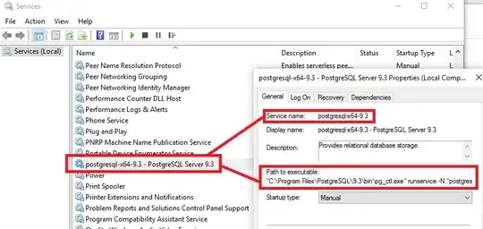

Type services.msc as previously mentioned and read the path-to-executable as follows;
Path to executable: "C:\Program Files\PostgreSQL\9.3\bin\pg_ctl.exe" runservice -N "postgresql-x64-9.3" -D "C:/Program Files/PostgreSQL/9.3/data" -w
Net service name is defined as postgresql-x64-9.3
So simply, whenever I want to shut down postgresql, I just type the following on a command line instance (to create a cmd instance, type windows+r and enter cmd);
net stop postgresql-x64-9.3
If you run another version of postgresql, you can just check the service name as explained and use this as a shortcut. Hope that it helps.
