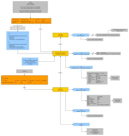

Availability of Device Links
During initramfs boot stage, not many symbolic links are available
for use with boot-up stage. We investigate
which device paths are available for encrypted swap.

In this /etc/crypttab example:
swap_unencrypted /dev/mapper/vg_swap-lv_swap_encrypted /dev/random none
swap space using memory-based randomized-key AND using VG/LV pathname,
this approach will take your existing swap partition and convert it to an encryp
ted swap space.
Basically, the following steps will
- disable hibernate,
- create an LVM partition for encrypted part of swap space,
- make a new entry in
/etc/crypttab
- get dm-crypt/LUKS to create yet another partition, swap_unencrypted.
- modify swap entry in
/etc/fstab
- Create swap space (
mkswap)
- Enable swap space ('swapon`)
all to re-encrypt the swap space now and after every reboots.

Now we have a pathway to a drive, a logical drive, but not yet an encrypted driv
e with random key pointing to /dev/mapper/vg_swap-lv_swap_encrypted.
Encrypted Swap Partition
Add or modify the following entry into /etc/crypttab:
swap_unencrypted /dev/mapper/vg_swap-lv_swap_encrypted /dev/urandom swap,cipher=
aes-cbc-essiv:sha256,size=256
Then activate the encryption and create yet another dm device under /dev/mapper block device:
Choose one of two commands below:
# cryptsetup open /dev/mapper/vg_swap-lv_swap_encrypted \
swap_unencrypted
or
# cryptdisks_start swap_unencrypted
[ ok ] Starting crypto disk...swap_unencrypted (running)...done.

Newly created block device to /dev/mapper/swap_unencrypted now exists.
Details on /dev/mapper/swap_unencrypted:
# cryptsetup status swap_unencrypted
/dev/mapper/swap_unencrypted is active.
type: PLAIN
cipher: aes-cbc-essiv:sha256
keysize: 256 bits
key location: dm-crypt
device: /dev/mapper/vg_swap-lv_swap_encrypted
sector size: 512
offset: 0 sectors
mode: read/write
Create Swap Space
Create the swap space:
# mkswap /dev/mapper/swap_unencrypted
Setting up swapspace version 1, size = 15.3 GiB (16382947328 bytes)
no label, UUID=8cd89984-9892-4d62-a9ba-ecfb6476379c
Now notice the UUID created for swap_unencrypted? This will always
be different for each reboot.

You could use /dev/disk/by-id.
But LVM offers more than enough sufficient protection by the virtue of YOUR unique naming convention of each the VG and LV partitions.
Above setup provides an uniquely encrypted swap space locator which will be scrambled
yet unrecoverable after each reboot (or in event of rare case, LVM remount.)
