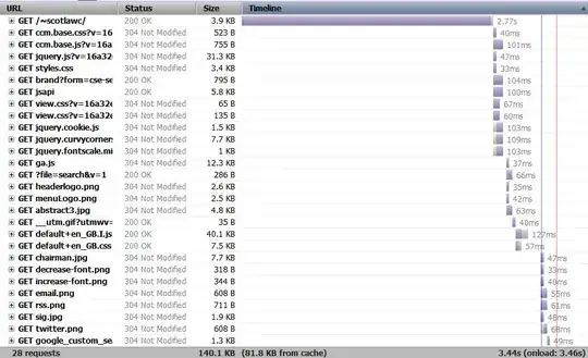

I've recently moved a client's website (using the concrete5 CMS) over to a VPS running Gentoo, Apache 2.2, PHP5 and MySQL 5 and I've noticed that Apache response times are pretty bad (it was the same on the old server), sometimes way up to 8-9 seconds, but more often between 300ms and 3 seconds (towards 300ms I don't mind). I know it's not network latency, since the server has a ping (from my location) of around 30ms.
Here's an example of the times (you can see it's snappy after the initial wait):
