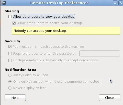

Under the System pull down in Gnome, launch the Remote Desktop App, System -> Preferences -> Remote Desktop. From here check the allow other users to view your desktop. Also set the security and notification sections accordingly.

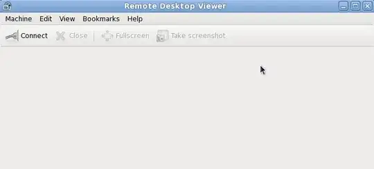

Once you're setup your Fedora system so that it will accept remote connections you can use a remote desktop client such as Vinagre, again a Gnome app, from the Applications pull down, Applications -> Internet -> Remote Desktop Viewer. Once this application comes up you'll need to open a connection to a remote server.

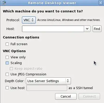

In the connection dialog select VNC for the connection protocol and put either the remote servers name or ip address and click connect.
