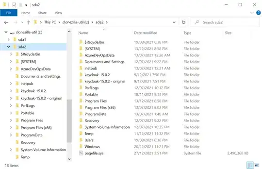

I've written a program called clonezilla-util which can mount Clonezilla archives in Windows.
You can mount to a drive letter using this command (requires the Dokan driver):
clonezilla-util.exe mount --input <clonzilla folder> --mount L:\
Then you can access the files in explorer:

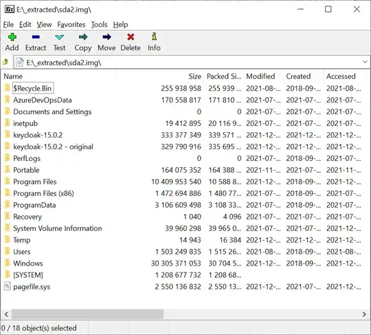

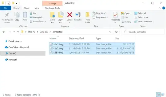

If you don't want to use the Dokan driver, you can extract the partition images using this command:
clonezilla-util.exe extract-partition-image --input <clonzilla folder> --output <folder to extract to>
That creates a file for each partition in the Clonezilla archive.
You can then use 7-Zip to inspect the contents:
