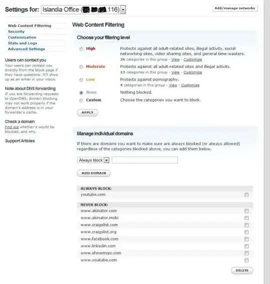

The router you mentioned is a perfectly capable router and can block IP addresses, but web filtering is a bit more advanced for most routers in that class.
Assuming that your staff is not made up of computer nerds who waste the day on Stack Exchange know what a DNS server does, I've had success with simply using OpenDNS to block Spotify and other social networking sites. It's a good solution, simple, very non-technical and free.
The downside is that you cannot filter anything finer than the domain name (so you can only filter all of spotify.com, but not filter spotify.com/customers while allowing spotify.com/users). The filters are all-or-nothing, there is no way to allow the bosses to surf for porn without blocking the other users (other than manually overriding their DNS server settings, which I've had to do for my clients using OpenDNS). And, by manually overriding the DNS server settings on the client computers, the OpenDNS filters are easily defeated.
For reference, you would create a (free) account with OpenDNS. Using their webfiltering dashboard (as pictured for one of my clients below), you can add spotify.com to the list of domains that are blacklisted.
You can then reprogram the DHCP server built into your router to change the DNS settings from whatever your ISP had provided to the OpenDNS servers, in this case, 208.67.222.222 and 208.67.220.220. Anyone going to spotify.com in the future would be met with an error screen handed out by OpenDNS.
