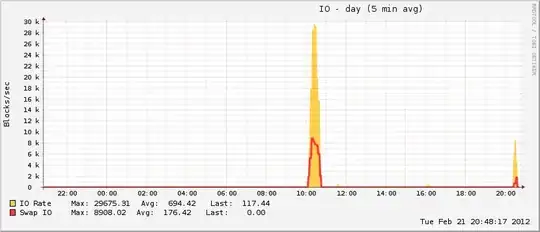

The OOM killer seems to be killing things despite having more than enough free RAM on my system:
27 minutes and 408 processes later, the system started responding again. I rebooted it about an hour after, and soon thereafter the memory utilization returned to normal (for this machine).

Also somewhat interesting is that while my pagefile grew during the event, it only reached ~20% of total possible utilization, which is uncharacteristic of true OOM events. On the other end of the spectrum, the disk went absolutely nuts during the same period, which is characteristic of an OOM event when the pagefile is in play.
