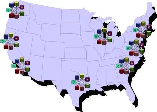

You would do well to consider where the Internet Exchanges (IXs) are located in your hosting region of choice. For example, in the US:
See also the peeringdb: https://www.peeringdb.com/private/index.php
That should get you in the ballpark. Anything off one of these highly interconnected IX points will add latency.
You can further refine this model by looking at your "locations." If they are physical locations, see which networks are there. If they are network locations, find out from the providers where they interconnect. Traceroute and mtr can be helpful tools but I would caution against relying on them entirely as routes can change at any moment.
