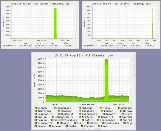

This depends on the services you are running. Wikipedia has a nice definition on it:
A denial-of-service attack (DoS attack) or distributed denial-of-service attack (DDoS attack) is an attempt to make a computer or network resource unavailable to its intended users. Although the means to carry out, motives for, and targets of a DoS attack may vary, it generally consists of the concerted efforts of a person, or multiple people to prevent an Internet site or service from functioning efficiently or at all, temporarily or indefinitely.
The term is generally used relating to computer networks, but is not limited to this field; for example, it is also used in reference to CPU resource management.
When you are running a web server you would see a huge spike in GET-requests, for DNS services this would bee lookups, ... The attack consists mostly off asking a lot of your server until the point it wouldn't be able to cope.

2You obviously like green - to the point it makes your graphs a bit pointless :-) – Coops Mar 05 '12 at 22:04
