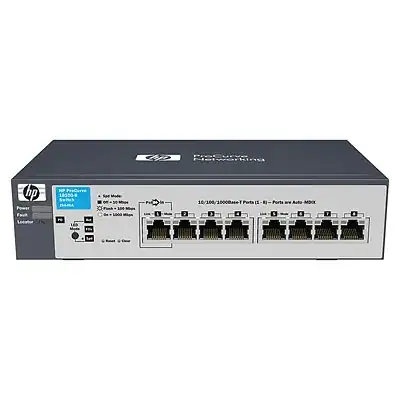

I'm in need of a gigabit switch that can be powered via PoE, rather than AC power. There isn't any AC power in the area where it needs to be installed. Is this possible?

The HP ProCurve 1810-8G Switch (J9449A) is an 8-port Gigabit switch that can be powered by an upstream PoE switch. I use it in environments where I can't accommodate a power brick or need to control power from a central location (e.g. a UPS in a central server room). They're also nice when you need to use small switches because of a lack of ethernet drops in a facility.

1Wow, I have never seen a switch that ran off PoE. Those might be useful to put on our mobile lab carts. – Zoredache May 17 '12 at 07:31
Ditto @Zoredache - this is the kind of thing I'd have almost ruled out directly. Interesting to know – Dan May 17 '12 at 12:04
Does it forward the PoE current? This one is not Gbit but is able to do that, but I'm interested in Gbit, too. http://www.veracityglobal.com/products/ethernet-and-poe-devices/outreach-quad-lite.aspx – mgutt Jan 25 '16 at 21:29
