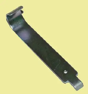

Another nice thing to have is a cage-nut puller.
This is a specially formed piece of metal that you can use to insert/extract the nut from the rack without cutting you fingers to shreds. You sometimes get one for free with a bag of cage-nuts. (They are hard to come by otherwise.)
