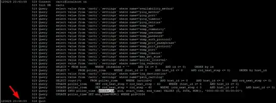

I enabled MySQL logging to make sure I'm not imagining things. Sure enough, when the error message is looped, the cacti.log reads as if it was querying like mad:
06/29/2012 08:44:00 PM - CMDPHP: Poller[0] DEVEL: SQL Cell: "SELECT count(*) FROM cacti.poller_time WHERE poller_id=0 AND end_time>'0000-00-00 00:00:00'"
06/29/2012 08:44:01 PM - CMDPHP: Poller[0] DEVEL: SQL Cell: "SELECT count(*) FROM cacti.poller_time WHERE poller_id=0 AND end_time>'0000-00-00 00:00:00'"
06/29/2012 08:44:02 PM - CMDPHP: Poller[0] DEVEL: SQL Cell: "SELECT count(*) FROM cacti.poller_time WHERE poller_id=0 AND end_time>'0000-00-00 00:00:00'"
But none of these queries are logged by MySQL. Yet, when I add my own database query code, it shows up just fine.
