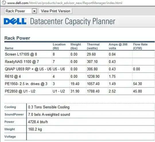

I have created on Dell's Power calculator ESSA, a map of the hardware I have:
- Total AMPS used is 5.8
- All three Dell's each have a redundant PSU
- according to Dell's site - that means that each PSU uses half of the said/needed Watt's.
- Each Dell is connected to 2 UPS's (both are PRP 3050 )
Q:
- My UPS's specs says it has a 8.5Ah - does that mean I can connect more appliances until I reach the MAX?
- What can I learn from this information that I have provided?
