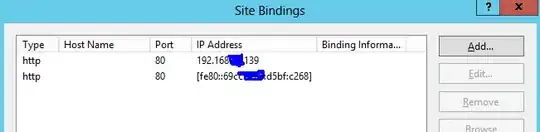

Bind to both!
We had an IIS web site whose code did an internal reference to itself, using the DNS name that the client had used. This process would always fail.
Another symptom was that a browser running locally on the server could not find the web site by the name of the server, only by the IPv4 address. That is, http://192.168.55.139 would work, but http://myhost would fail. Using ping myhost would, by default, return the IPv6 address (ping myhost -4 would return the IPv4 address).
The fix was to open IIS and change the Bindings of the web site to bind to the IPv6 address, as well as the IPv4 address.
- 455
- 3
- 7
- 17
6[It's not necessary to obfuscate private addresses.](http://meta.serverfault.com/q/963/126632) Though, you should also bind to your global IPv6 address so that your site can be reached externally via IPv6. – Michael Hampton Jun 03 '14 at 17:38
3Having a service accessible both internally and externally is easier when you don't use NAT. And it is easier to avoid NAT, if you are using IPv6. But blindly connecting to a hostname provided by a client sounds like a design flaw. It is entirely possible for the client to send you a `Host` header with a domain name that doesn't belong to you. – kasperd Feb 09 '16 at 08:54
