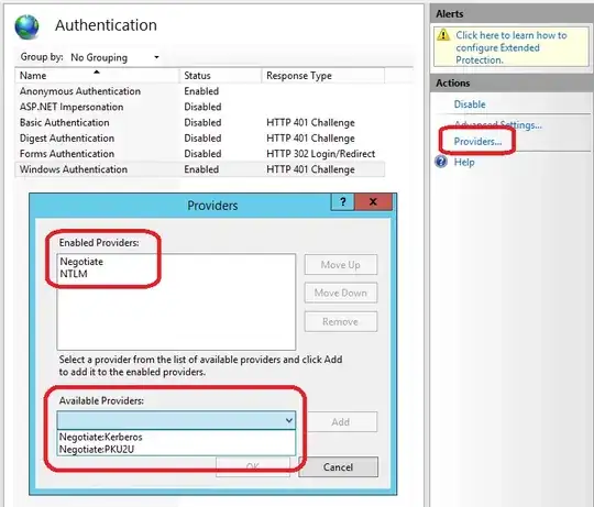

If you have access to your IIS server then the answer is much simpler than inspecting HTTP traffic: Simply view the site Authentication module config for Windows Authentication.
- In IIS Manager
- Select your site
- Click on the Authentication module
- Select Windows Authentication
- Select Providers...
