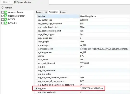

I went through this routine myself with MySQL until I tried out Navicat for MySQL. Later I upgraded to Navicat Premium. Both have a Monitoring tool that contains a tab with all of the server variables in one comprehensive list. Here's a screenshot with the log_error server variable:
log_error server variable in Navicat Server Monitoring Tool
You can also set the variables right there in the list.
