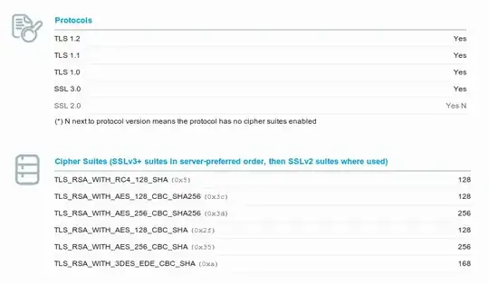

I thought this was a configuration issue, until I ran a ssllabs.com test, which reports all 6 ciphers fine:
So can anyone explain why my openssl tests are failing to connect using SHA256 ciphers?
