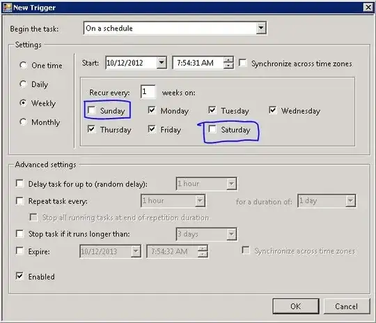

If this is a Windows Server 2008 - you can try the below from the Task Scheduler -
You can then uncheck the days you dont want the task to run as I have highlighted in blue.
I believe this is what you are looking for...

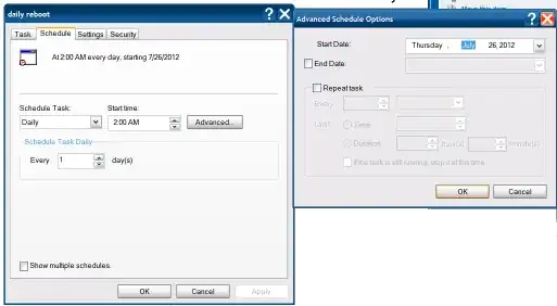

Well, One way I see to do this is to the task to end on a holiday, then have a second task starting on the next working day, and ending that task the next holiday. Rinse and repeat per holiday.
The newer versions of task scheduler does seem to let you string events together, but I don't see any option not to run a task on a specific day.

This looks cool. Say we have 10 business holidays, then will have 10 scheduled tasks. Thanks a lot. – user47289 Oct 19 '12 at 08:51
Could please give more info on string events together on the new task scheduler. – user47289 Oct 19 '12 at 09:00
On windows 7 (I don't have server 2012) You can set multiple triggers for the same task - so 10 triggers rather than 10 separate tasks under create tasks. Create basic tasks is closer to the options windows XP does. – Journeyman Geek Oct 19 '12 at 09:47
