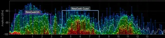

WiFi access points typically look like this on a spectrum analyzer (the numbers along the bottom are the WiFi Channel Number):
There are three WAPs in this image, on channels 1, 6, and 11 - Notice that there is "bleed over" into the adjacent channels (which is why in a generally clean environment many people use channels 1, 6, and 11: They are far enough apart that they don't really overlap.
By looking at a spectrum analyzer you can determine which available channels are "cleanest", and then assign them to your access points, taking into account RF bleed-over to ensure that your access points don't (substantially) interfere with each other - this is what your colleagues are referring to when they talk about "managing adjacent channel noise".

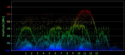

If you mess up and have access points too close together they essentially get into a shouting match to see who controls the frequency at any given time. The image below shows two access points on what appear to be channels 10 and either 11 or 12 (notice how their peaks are right on top of each other).
Each AP needs to wait until the other is quiet before transmitting, or crank up its power to drown out the "interference" from its neighbor (hurting performance for both networks).
