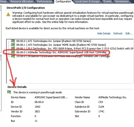

It took me a number of different configurations, but I finally managed to configure the HighPoint RocketU 1144A USB 3.0 PCI Express card for DitectPath passthrough:

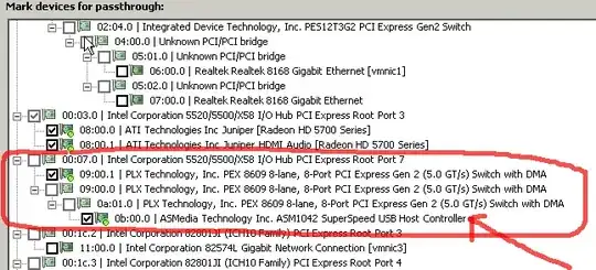

The first few times I tried, after rebooting I still received the "The host needs to be rebooted to apply configuration changes" warning, even after rebooting the host. Finally I found that by moving the USB 3.0 card to the 3rd PCIe slot, I was able to get the passthrough configuration to stick.
I also note that the device shows up as a "ASMedia Technology Inc. ASM1042 SuperSpeed USB Host Controller" when it actually should have 4xASM1042 chips on it. I also had to pass-through the PLX Technology, Inc PEX 8609 8-lane, 8-Port PCI Express Gen 2 Switch to make the configuration changes stick.

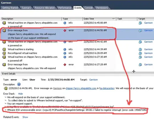

Now, however, I am stuck trying to attach the ASMedia Technology ASM1042 device to a FreeBSD (FreeNAS) virtual machine. When I add the device as a PCI passthrough device to the virtual machine, I am unable to power on the virtual machine:
VMware ESX unrecoverable error: (vcpu-0) PCIPassthruChangeIntrSettings: 09:00.1 failed to register interrupt (error code 195887105)
I tried passing through only the ASMedia ASM1042, only the PLX PEX 8609, and both the two devices. None of these three configurations worked.

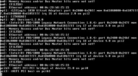

to my .vmx file, and this did enable me to boot the FreeBSD 8.3 (FreeNAS 8.3.1) VM... however the virtual machine hung at boot here:
I expect that I need to make some other change. The VMware PDF document they linked to describes "linked devices", and I expect there's some sort of linking going on whereby the 4xASM1042 chips (because the 4 ports on the USB 3.0 card each have their own channel) need to be linked through the switch... or something... but I am unsure of technically what is going on or how to proceed.
