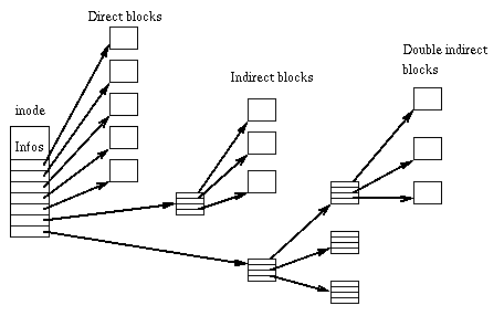

The file system performance might suffer from large numbers of blocks used for a single file, so a larger block size might make sense. Specifically ext2 has a rather limited number of block references which can be stored directly with an inode and a file consuming a large number of blocks would have to be referenced through four layers of linked lists:
So obviously, a file with less blocks would require less reference layers and thus theoretically allow for faster access. This being said, intelligent caching is likely to cover up most of the performance aspects of this issue in practice.
