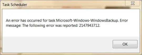

@LuckyLuke The event data is here: http://pastebin.com/92GezLx6. Also, I went back and filtered by time in Event Viewer... I found this: Task Scheduler failed to log on "TaskScheduler:Task:{948A9ABA-1A81-4AEC-801D-3A05560AC928}" . Failure occurred in "LogonUser" . User Action: Ensure the credentials for the task are correctly specified. Additional Data: Error Value: 1326. I went into Task Scheduler, went into the task settings, and re-specified the username. When I clicked OK, I got a credential popup, and after entering the password, I got this: http://i.imgur.com/3HzfxVk.png – Micha May 23 '13 at 07:00
@MathiasR.Jessen Looks like I found the source of the problem. Now it's just a matter of figuring out how to fix it... – Micha May 23 '13 at 07:04

As it turns out, that was the Backup scheduled task failing to start. Apparently, at some point the Group Policy setting "Network access: Do not allow storage of credentials or .NET Passports for network authentication" got enabled. This was disallowing storing the credentials for use with the scheduled task, as seen in the error message:
A quick Google search later, and the cause was revealed. I was able to specify credentials in Task Scheduler, and tomorrow morning I'll see whether or not the problem is solved. Still don't know where "@@CyBAAAAUBQYAMHArBwUAMGAoBQZAQGA1BAbAUGAyBgOAQFAhBwcAsGA6AweAkDA0AAOAEEA5AQQAIEABBQLAEDABBAOAEDAtAANAEEAFBwQA0CA4AAMAEDAEBQLAMDABBAMAUDA1AgNAADABBwQAkDAyAAOA0HA" came from, but hopefully that's no longer important. Thanks for all your help!
