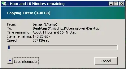

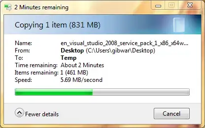

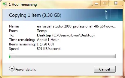

Copying initiated from the laptop
Server -> Laptop
(source: gibixonline.com)
Laptop -> Server

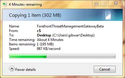

Copying initiated from the server
Server -> Laptop

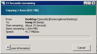

Unexpectedly having the server copy a file from the laptop to itself results in speeds I would expect. (Laptop -> Server)

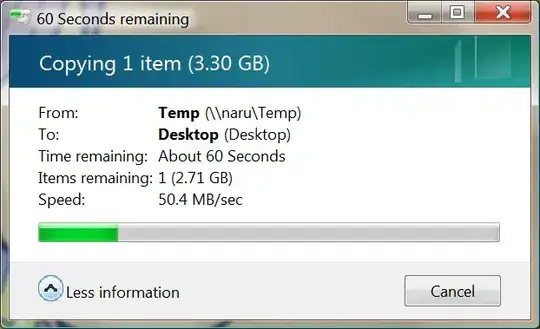

I stated earlier that the other machine on the same switch doesn't have this issue. High DPI is turned on since this is displayed on a HDTV.
Server -> HTPC
