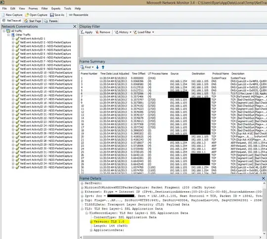

You can open that ETL file with Windows Performance Analyzer, and also with NetMon. (The latter will likely be more useful to you.)
Here's a screenshot of that trace file I just generated:
(Open in new tab to see fullsize)

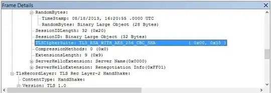

Edit: To find the exact cipher mode being used, locate the "HandShake: Server Hello" packets:
Here is a Microsoft support article telling you how to interpret the bytes of the packet manually, but Netmon will do it for you.
You could come up with a packet trace filter that only contained packets of this nature. If there's a better way to get this data I'd like to know about it.

Close. I origally accepted the answer, but I can't work out from this what actual cipher suite is being used. "TLS 1.0" is too vague. I can see in the handshake packet a bunch of suites being offered ("TLSCipherSuites: TLS_DHE_RSA_WITH_CAMELLIA_256_CBC_SHA { 0x00, 0x88 } etc", but I can't tell which one is being picked. – Frederik Aug 18 '13 at 18:18

1Edited my post. Yes the precise cipher mode is in there too. – Ryan Ries Aug 18 '13 at 21:11
